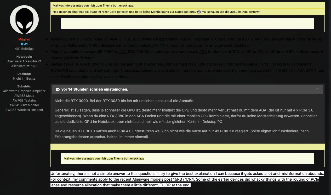

Mal was interessantes von nbfr zum Thema bottleneck aga.
Hab gesehen einer hat die 3080 im razer Core getestet und hatte keine Mehrleistung zur Notebook 2080 ;) mal schauen wie die 3080 im Aga performt.
  • Anyone with the i7-9750h and an AGA RTX 2080 or lower will experience little to no bottlenecking due to the AGA when using an external monitor of 1440p or above. Folks using 1080p displays can expect a deficit of 5-7% at most as compared to an equivalent desktop.
  • People with elite hardware (i9-9880h / AGA RTX 2080ti) should expect a worst case AGA bottleneck of 10% at 1080p, 7% at 1440p and 5% at 4k compared to an equivalent desktop.
  • Severe cases of AGA bottlenecking can be seen at the extremes, with as much as a 30% decrease in framerate seen in certain esports titles played at 1024x768 resolutions and low settings. These experiences are rare and limited to situations where very high end hardware (51m + 9900ks + AGA RTX Titan) is used with exceptionally low visual settings.
Unfortunately, there is not a simple answer to this question. I'll try to give the best explanation I can because it gets asked a lot and misinformation abounds. For context, my comments apply to the recent Alienware models post 15R3 / 17R4. Some of the earlier devices did whacky things with the routing of PCIe lanes and resource allocation that make them a little different. TL;DR at the end.
Cause of the AGA Bottleneck
The bottleneck imposed by the AGA is a direct function of how much information needs to be sent over it's 4x PCIe 3.0 bus. The interface technically suffers a very small amount of bandwidth loss compared to the 4x PCIe 3.0 bus of a typical desktop computer because of the way it is implemented in the AGA. The caldera connector, cable length and inferior EMI shielding inherent in it's design all contribute, but it's a very small amount we can ignore for the sake of explanation.
The amount of information transmitting the PCIe bus is primarily determined by how much work the CPU has to perform and subsequently transmit to the GPU and vice versa. In most cases--especially when gaming--the majority of PCIe traffic navigates the bus from CPU to GPU, so this is where we are most worried about bottlenecking. This assumption does not necessarily hold when the GPU is working on a task in a headless configuration (no display being drawn at all) or when an image is being rendered on one GPU and drawn on a display attached to another GPU. For simplicity, let's assume we are discussing the AGA bottleneck when gaming on a display directly attached to the GPU in the AGA. When using the AGA to render an image and output it on the internal laptop display, users will experience a wide range of performance results, influenced by both the model of laptop, the version of Windows being used and the OS settings applied. Microsoft has been very active on finding new ways to accommodate systems with multiple GPUs, rendering and outputting on different GPU devices, GPU scheduling, so the results in such a condition likely to change even over the next few months.
Examples of where the AGA bottleneck does not exist
If an AGA bottleneck is a function of how much information transmits the PCIe bus, let's use a few practical examples to understand where the PCIe bus limits do and do not exist. I am going to generalize a bit here for sake of example, but the result holds true on average. In almost all cases, a CPU will have more information to transmit across the PCIe bus to the GPU when frame rates increase, all else constant. Frame rates are not the only factor, but they are an easy one to understand. For most games, a CPU generates much more information to send to the GPU at 120 FPS compared to 60 FPS, assuming the frame rate is all that changes. Such is the case when a frame limiter is used and no other visual settings or the resolution is changed. High CPU loads alone are insufficient to create a bottleneck. For example, in Civilization 6, the AI turn times towards the end of the game can get very slow while the CPU works hard to calculate the thousands of actions the AI must perform. Despite working the CPU hard, these late game AI turns have largely no effect on any bottleneck imposed by the AGA because very little of this work performed by the CPU needs to be sent to the GPU.
Similarly, extremely high GPU loads alone do not exacerbate an AGA bottleneck. A very simple game requiring minimal CPU power but drawn at an absurd 16k resolution will not require a lot of information sent across the PCIe bus, but will require an enormous amount of horsepower from the GPU. Another extreme example of GPU bottlenecking with minimal stress on the PCIe bus exists in a lot of non-gaming GPU work such as data science and crypto currency mining. If you have a moment to look at a crypto currency mining motherboard, you'll find many have a dozen or more 1x PCIe 2.0 slots to populate with powerful GPUs. Despite each one of these slots having 1/8th the bandwidth of even our lowly AGA, the 1x PCIe 2.0 interface does not bottleneck even the most powerful GPUs when it comes to crypto mining. The PCIe bus in this case is only used to send raw data to fill the VRAM, which the GPU slowly processes. The rate the GPU works through the data stored in its VRAM is slower than even the abysmal bitrate of a 1x PCIe 2.0 interface. Again, no bottleneck exists.
Where the AGA bottleneck does exist
So if the above extreme cases are where an AGA bottleneck does not exist, where will an AGA bottleneck be the most pronounced? The answer is where neither the GPU nor CPU are bottlenecks themselves, yet the information transmitted from CPU to GPU remains high.One such situation exists when playing relatively modern titles at low resolutions, and with exceptionally high frame rates. Such is the case with esports titles, where a game like CS:GO is still regularly played at very low resolutions of 1024x768. Even these games played on these competitive graphics settings are likely to hit a CPU or GPU bottleneck before the PCIe bottleneck on some hardware. Such was the case of my first AGA compatible 15R4 (i7-8750h), where I used a GTX 1080 in the AGA. The worst PCIe bottleneck I ever experienced (and was able to reliably measure) with this system was in CS:GO at 1024x768 and low settings. The AGA bottleneck in this scenario was an average frame reduction of about 10%, as measured against the exact same GPU in a desktop with an 8700k tuned to the equivalent TDP and frequency limits of the Alienware's 8750h. The case of CS:GO at 1024x768 low was the worst result I was able to identify after trying about 8 different games, all at unrealistically low resolutions. Rocket League also exhibited very similar behavior to CS:GO at 1280x800. While this is a seemingly significant result, the resolution is ridiculously low. I never experienced a bottleneck with this 15R4/AGA GTX1080 combination when playing a game at 1080p resolution or higher, no matter the game or graphics settings configuration. The CPU or the GPU would hit a wall before the PCIe bus bottlenecked.
The 15R4 and GTX 1080 is showing its age, so what about a more modern Alienware configuration? At the other end of the spectrum is my current system: an Area 51m with a 9900ks (tuned to only 4.4Ghz for heat & noise) and a Titan RTX in the AGA. This is more power than almost anyone else will try to force through the AGA, but it presents a useful anecdote at the other extreme end of the spectrum. In the same conditions as the earlier CS:GO test on the 15R4, the Area 51m exhibits an average reduction of 28% in framerate compared to the exact same CPU (identical power and frequency limits) and GPU in a Z390 desktop build. While this is a seemingly huge deficit in comparison to that exhibited by the 15r4, remember this is at 1024x768, low settings and with the best CPU + GPU combination available in an Alienware laptop + AGA (at least until the A51m R2 hits shelves.) At a more realistic 1080p resolution, the deficit was only 11% on average compared to the desktop equivalent. The gap shrunk to 7% and 4% at 1440p and 4k respectively.
While I was never able to reliably measure a drop in performance for the 15R4+GTX1080 system compared to its desktop counterpart at 1080p or above, the same cannot be said for the 51m + Titan RTX system. In the 8 games I tried, my experience is that you should expect a decrease in performance of 5-10%, compared to a desktop equivalent using the AGA with this level of elite hardware at 1080p. To oversimplify this result a bit, as the average FPS of the game increases, so too will the prevalence of an AGA bottleneck. At 1440p, the performance difference shrinks to between 4-7% and at 4k it closes to 2-5%.
I have also tried similar testing the 51m with a 2070S and 2080 in the AGA. I concluded there is effectively no practical difference between using them in the AGA compared to a desktop. Perhaps 1-3% variation at most, but I'm certainly not sharp enough to recognize a difference that small and it could very well be within the margin of error for the hardware. The difference grew slightly at 1080p, but still always remained within 5% of the desktop.
Last thoughts
A few last things to mention. First, Nvidia is emphasizing GPU features such as tensor cores and raytracing that largely perform without help from a CPU. Turning on raytracing on a compatible AGA GPU results in the expected reduction to framerates we would expect from raytracing, but it causes the GPU to bottleneck earlier, reducing the performance impact of an AGA attributable bottleneck. Said another way, the cost of enabling raytracing on an AGA RTX GPU is comparatively less than enabling RTX in a desktop. If a desktop were to drop 20% framerate performance by enabling RTX, enabling it on an AGA RTX GPU might only drop your framerate by 15%. This isn't particularly novel, but if features like raytracing are important to you, the AGA won't hold you back.
Second, Microsoft is moving towards more work being done on a GPU without help from the CPU through scheduling and DX12. I expect this to further reduce the stress on the PCIe bus as functions get moved directly to the GPU and no longer need to traverse the PCIe bus. I plan to test some of the new Windows and Nvidia driver updates in the AGA next month to see what improvements have been made.
Third, many gamers with the money to spend on a fancy Alienware laptop, AGA and another GPU will also do their AGA gaming on an external monitor with a resolution higher than 1080. Very little bottlenecking exists under these conditions, even with extremely high end hardware. Only the most devout esports gamers who want to play at exceptionally low resolutions (<720p) and high FPS should absolutely shy away from the AGA in favor of a desktop because of AGA bottlenecking.
Lastly, a well-thought-out system and properly configured game settings will always provide the best experience. Please don't pair an 8750h with a 2080ti and expect to get the same FPS as people with the same GPU in a 9900k desktop. Your laptop chip is inferior to the desktop ones used for GPU reviews. Even the 9900ks in my 51m is grossly inferior to the same chip unrestricted under Noctua copper in a desktop. These are not the fault of the AGA, but rather the result of our world's current fascination with thin-and-light machines. You can always modify your graphics settings to find the right balance of visuals and frames that work to minimize any premature GPU, CPU or AGA PCIe bottleneck.
Overall, the AGA is still a fantastic performer in 2020 and outperforms any TB3 enclosure.
TL;DR

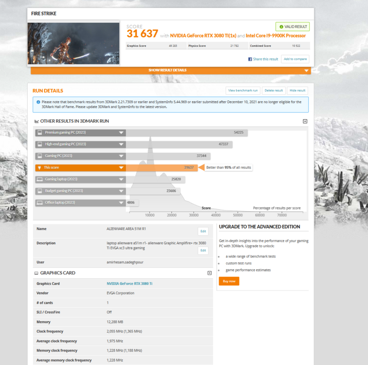

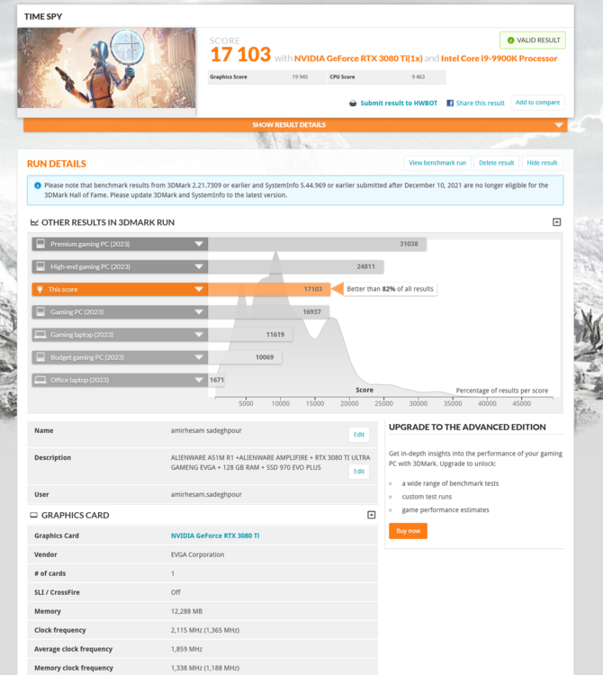

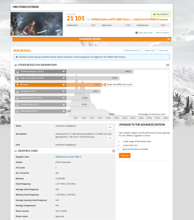

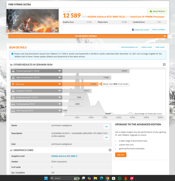

Betreibe eine RTX 4090 mit nem Alienware Area 51m Laptop
und habe keine Performance verlust so wie ich das sehe laut benchtest von games erhalte ich min die fps wenn nicht sogar ein paar fps mehr
spiele an nem OLED 4k 120hz
hier nen 3dmark test
https://www.3dmark.com/3dm/81227816
