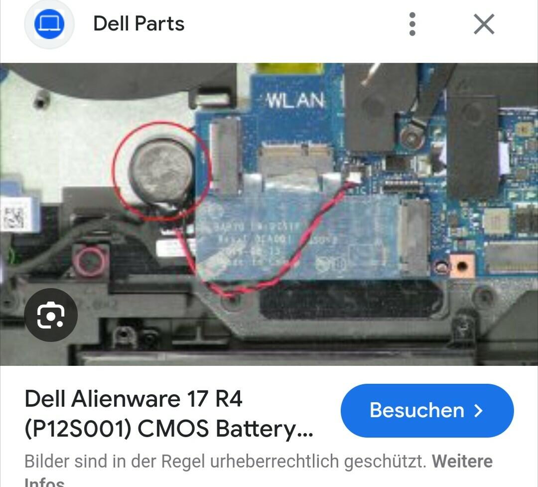

Die BIOS Batterie trennen sollte lt. Bild aber auch kein Hexenwerk sein🙄

Clearing CMOS settings
Remove the base cover.
Remove the battery.
Remove the coin-cell battery.
Wait for one minute.
Replace the coin-cell battery.
Replace the battery.
Replace the baseoCver.
https://www.dell.com/support/manuals/de-de/alienware-17-laptop/alienware-17-r4-servicemanual/clearing-cmos-settings?guid=guid-da302964-388b-418a-a7b8-127d24fb3fd5&lang=en-us
