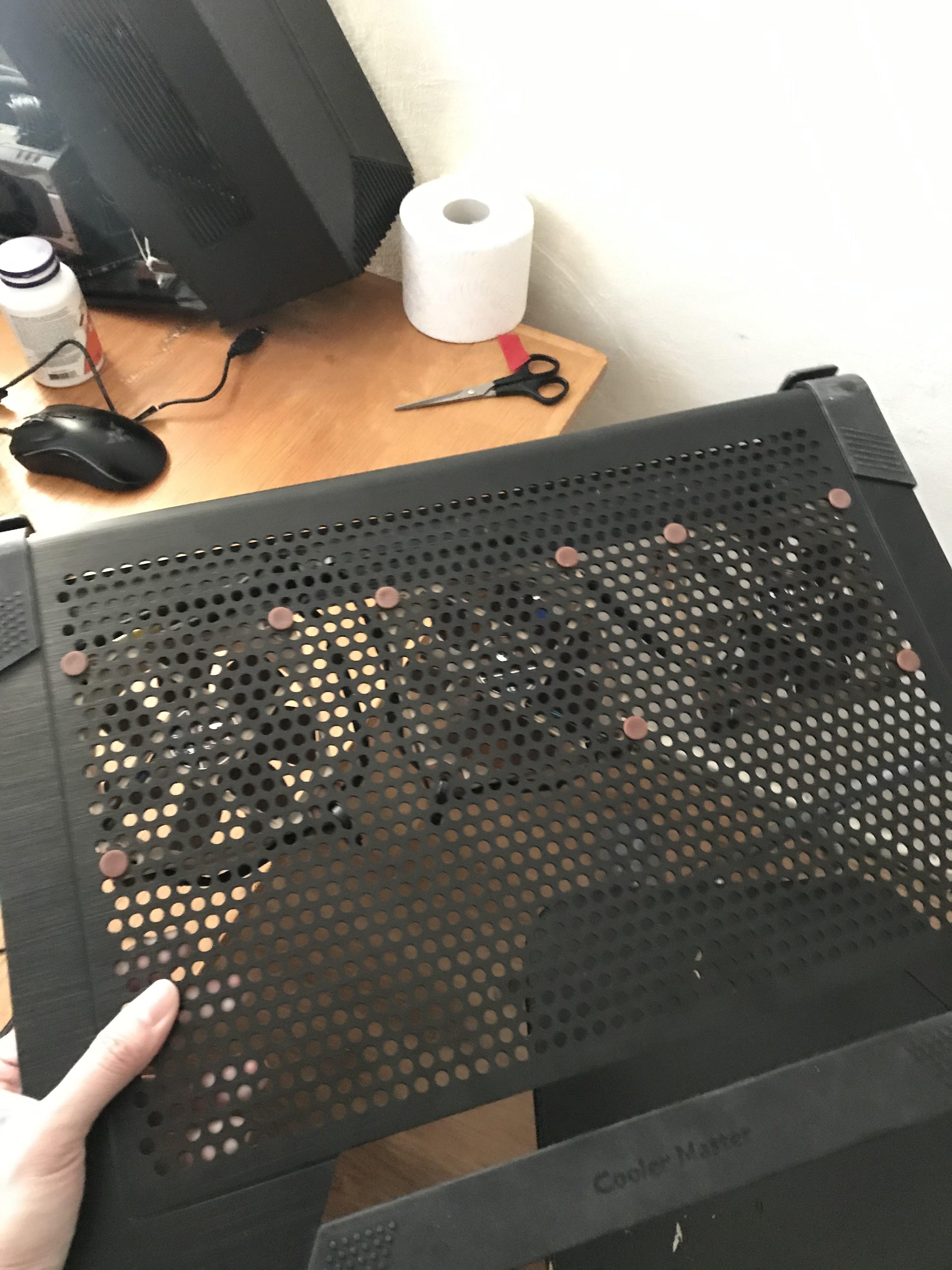

The modification look promising but is it suitable for Alienware 15r4 heatsink?
It seems like the space between heatsink and back cover is not enough for this mod :(

Hi, I can't say if the mod fits in the AW15 R4. Honestly, with a modded U3-cooler you get much more cooling performance without changing anything on the case or heatsink. You can find more detailed results about the mod in this thread:

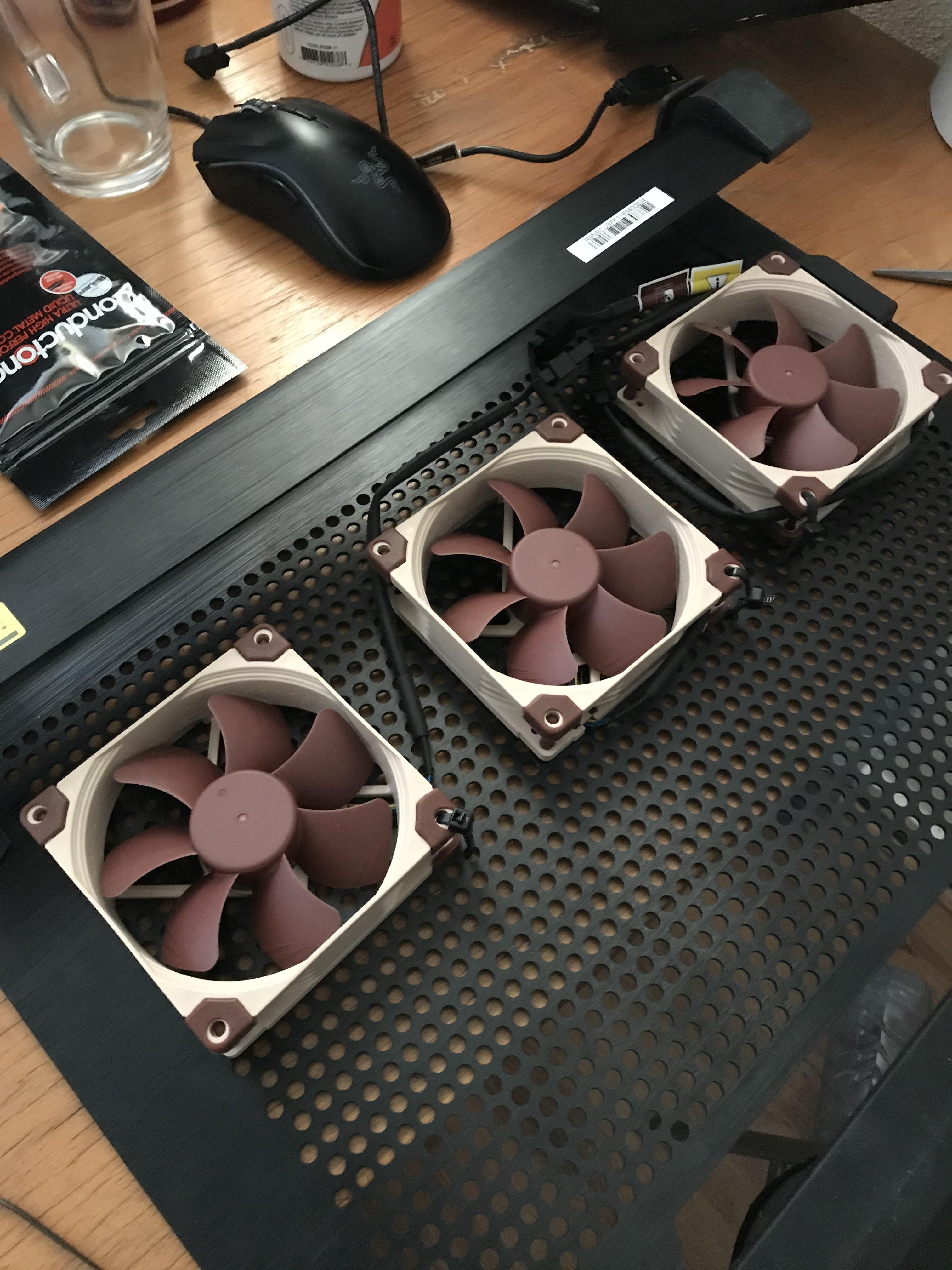

Besides, do you still selling a modded U3 cooler? ( with Noctua fan and I want to customize it a bit by using Noctua Redux lineup)
Yes, I'm still building the coolers for the community. Getting a used U3-cooler isn't always easy, but we'll find a solution if you want one. As for the fans, I can install any standard 120mm PC fan.

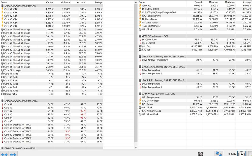

The maximum CPU clock I can reach is 4.2 - 4.4 Ghz (with UV & TDP limit at 55-60W)
In my testing with the AW17 R5 and the 8950HK was the highest longterm avg-load about 70w in realword-gaming (FarCry5). This was only possible with all mods, the U3-cooler (3x Noctua NF-A12), NB fans 100%, LM on CPU & GPU + UV (CPU: -155 @ 47x / GPU: 0.875mV @ 1.800 MHz)
In CPU stresstest only like CB R20 I was able to use the full 110w powerlimit. Back then I had a conversation on the topic in the NBRF (link). An example with Realbench over 1h with 95w avg on CPU + GPU load.
vor 14 Stunden schrieb heo44:
the clock speed drop to 3Ghz and throttling like crazy, it is nearly impossible to maintain at 4 Ghz
because of the temperatures? Often people complained about the 800Mhz drop as well. A modded U3-cooler helps here a lot. Especially with the old models like AW17 R4/ R5, AW15 R3/ R4 and so on.

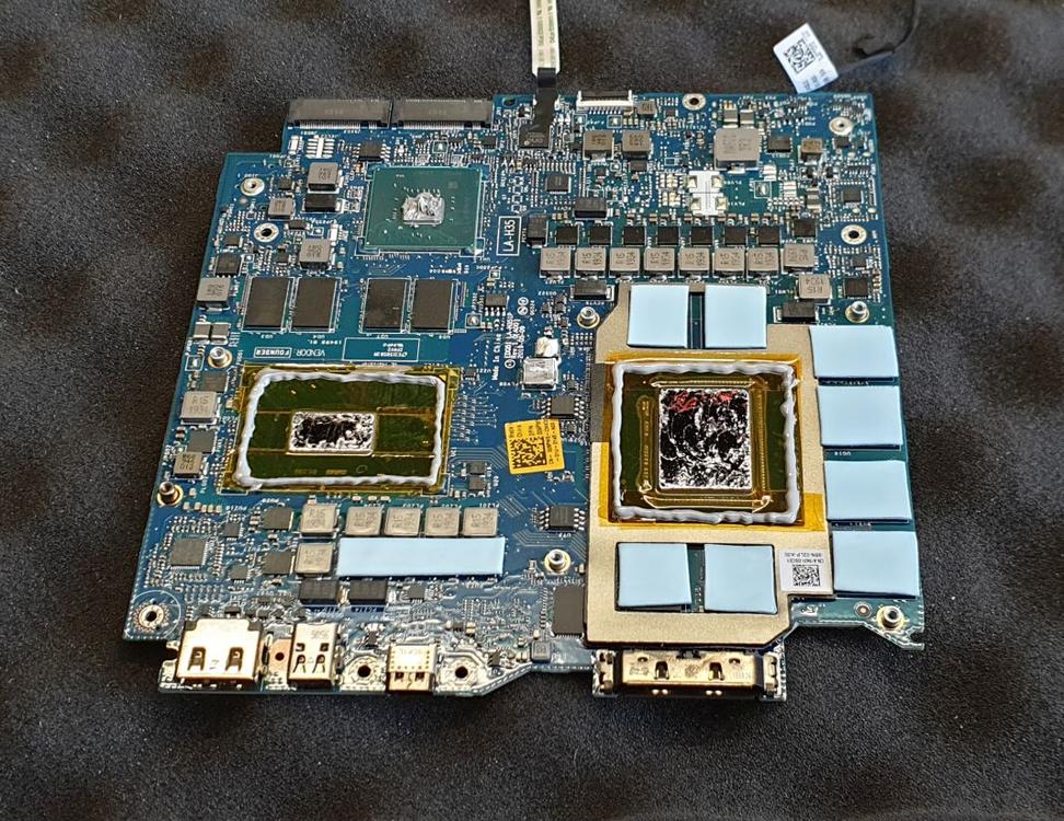

I did everything to solve that problem (repaste, fix the pad, clean the fan) but there is one thing that improve the performance
Repaste with thermal paste or liquid metal (LM)? It's huge different for the 8950HK.
With my leakage-protection it's absolutely safe. I've been doing this for years now on many devices and had never any problems with it.

Hi man, I am planning to build my own U3-modded and I have a question.
Can I use the Noctua 60x25mm or 80x25mm fan? And I will plan to buy 3 fans for my alienware 15r4.
If it is not a good choice, could you elaborate this for me?

Honestly, with a modded U3-cooler you get much more cooling performance without changing anything.
Hi, please use my thread about the U3 cooler. There you'll find all the important information and pictures.

Version-3 (USB):
  • 3x Noctua NF-A8 5V PWM - 21,34 €
  • 1x Noctua NA-FC1 PWM Controller - 18,90 €
  • 3x Lüftungsgitter 80mm - 1,50 €
  • 1x U2-Kühler - 20-30 €
  • 1x Arbeit & Material - 45,00 €
  • 1x Versandkosten (DHL 5kg Paket) - 7,50 €

Hi man,
I did follow your instruction and it work fantastic. Overall, the max temp (at 50% fan) was drop 20 degree Celsius without the Liquid Metal.
